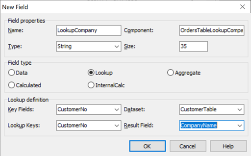

We would like to have the grid display the CompanyName from the CustomersTable instead of the CustomerNo from the OrdersTable. This can be accomplished by creating a lookupfield in our OrdersTable. Here are the steps to do this.
  1. Dbl-click your OrdersTable and then right click the blank are and select Add All Fields. We need to do this before we can create our lookup field.
  2. Now right click the field list again, and now select New Field. This will bring up dialog where we can create our lookup field. You can assign the properties as in the dialog below. Click OK to save your changes.
  3. Now let us add this newly created lookup field to our grid
  4. Dbl-click the grid, and select Add Field, followed by selecting the field LookupCompany. Click OK to save your selection. Now your grid should show this field from your CustomersTable.
